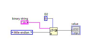

So I assume you have a string with this data.  Just use the Unflatten From String to convert the string to an I32.  There in an input to that function to set the endian.  You may have to set that to Little Endian.
Thanks for the reply.
I can see the binary string being converted into an 8 byte, little-endian (least significant byte first) integer value.
Since my output is in hex, I guess I will have to convert that into a binary string first, before I can convert into an integer.
How about the 2's complement part, don't I have to take care of that before I can do anything?

So you are saying you have an 8 character string of hex characters, and that represents a 4-byte integer?
You don't need to worry about the 2-'s complement first.  Get the 8 hex characters converted to 4 bytes first.  Then use CrossRulz's example to convert those 4 bytes to an I32 integer.
