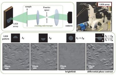

I am working on differential phase contrast imaging project,
Where, I have to generate the differential phase contrast image from two images taken with opposite illumination angle.
Steps to generate the DPC image
1) Add to images .................................................................get image 1
2) Subtract Two images from each other.............................get image 2
3) Divide image 2 / image 1................................................(DPC image)
Equation is = DPC(image) = I(L) - I(R) / I(L) + I(R)
I(L) = image taken by illuminating the left half circle.
I(R) = image taken by illuminating the right half circle
Illumination pattern
LEFT half circle(light on LEDS)LEFT half circle(light on LEDS)
RIGHT half circle (light on LEDS)RIGHT half circle (light on LEDS)

what I am doing is,  if I do summation of two images I will have images like sown below (I(T) + I (B)) and when I use that above equation I will have dpc image like shown below.
