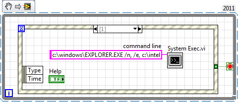

Something like this?
Specify the folder you need in the command line argument, in the above example I have C:\Intel

Thank you very much for your reply.
I tried with given figure but I didn't get success.
I am already dealing with producer consume event here I am attach my example vi if possible then please let me know that what should I do in order to open folder at any location.

The Help that aCe posted will not work if you intend for the help to be displayed immediately. Since it is queued it will not be processed until the run is complete if it is currently running. This also means that if the Pause button is pressed the help will be delayed for quite some time. Also, you should avoid the use of local variables to control state information. The state machine should maintain all of your state information. The producer should only detect the events and pass the messages to the consumer. What you are encountering is a classic issue with the producer/consumer with the consumer acting as a state machine. Interrupting the flow of states with new events of a higher priority can be problematic. Simply placing items in the front of the queue may not always work correctly. There are some examples of implementations that use multiple queues which can create prioritized messages.

Thank you for helping.
Yes Mark is right that when help is pressed then its not execute immediately.
So what kind of changes I need to do so when ever I pressed help then its execute immediately.

Accepted by topic author AnkitRamani
I think problem is solved now...
Here I have attach screen shot of the solved Problem that might be help.
Thank you very much for your help and time.

If yopu display the help inside the event structure there is no need to post the message to the consumer queue as well. Also, you need to understand the if you place code in the event structure that requires a long time to execute you will delay any other events from being processed. This can result in a sluggish UI.
