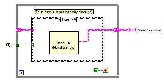

A simple way to do this is to make a vi with your predefined array inside.
Then you can use it where needed in your program.
A more robust solution would use the First Call function to read the data from a file
and store it in a shift register.
