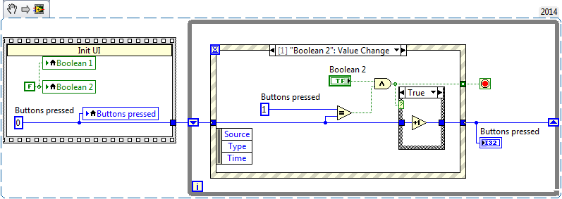

If you want your code to go through a number of states in a very orderly manner, you might want to use a state machine. Here's a state machine using an event structure. The state is stored on the shift register and keeps track of what's happend previously. When the "right thing" happens, you move forward in your state.
When you are done with all your states, you wire "true" to the stop of the loop.

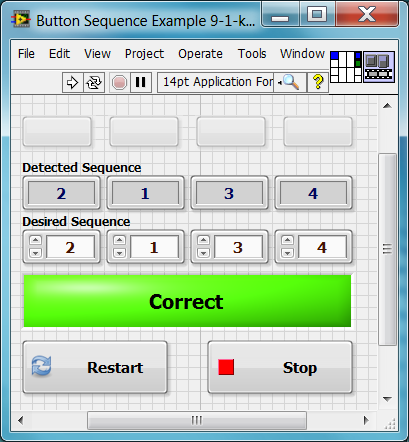

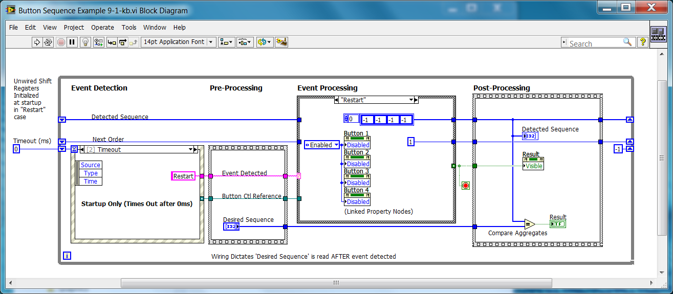

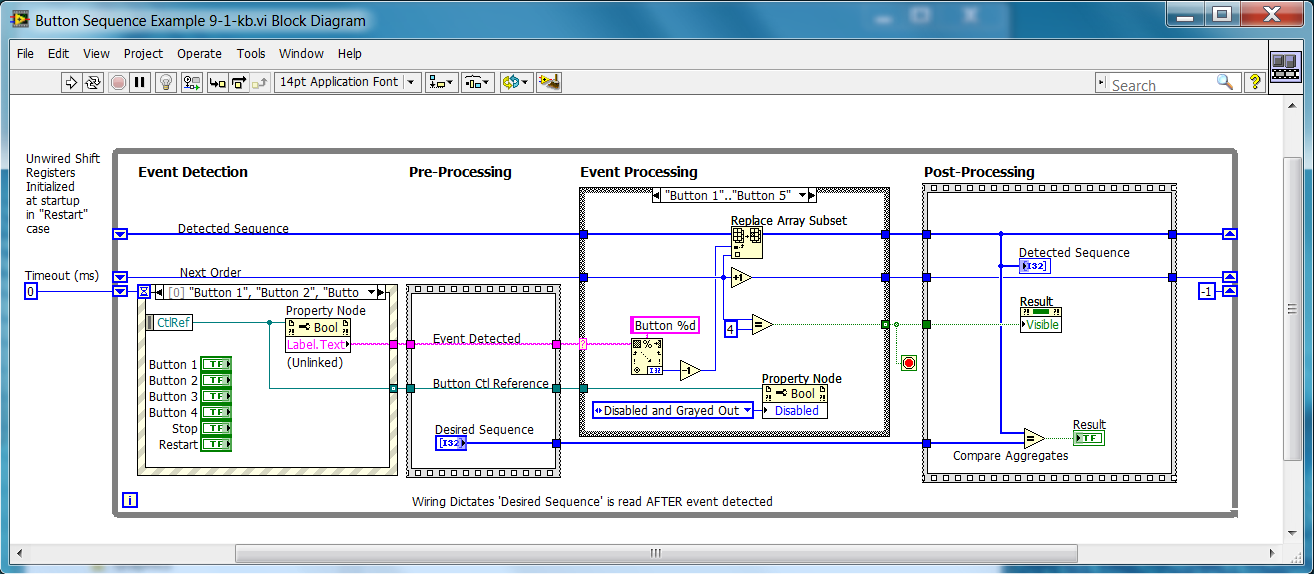

  Your Producer-Consumer model is actually very close to working.  In the original screen-captured version it looks like you're trying to use the sequence structure to capture the order, but in reality you will only capture the logical AND of all 4 buttons with no information about the order in which they were pressed.  The sequence structure does not by itself wait for an event to occur inside the frame, which means all 4 frames will be read as fast as the processor gets around to reading them - which will be very fast.
  I made some changes to your VI and renamed it Rev 1.  See if that makes a little more sense with the notes I made on the front panel.  I also did a different version with a single loop and some added functionality (-kb), just in case your'e interested in another way to look at it.

Kurt
