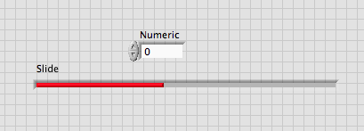

If you only need horizontal or vertical lines, try the progress bar controls.  The numeric is shown default size for comparison.
Lynn

Sounds interesteing.  Yes a picture control can do this for you and I'm always impressed with the amount of work that some put into making picture controls, not look like picture controls.  But a much easier way, if you can get away with it, is to use normal controls skinned to look different, with constant images as a background.
Like johnsold demonstrated that standard controls can make lines and movements.  Picture Rings can be used to cycle between static pictures too.  The reason I recommend normal controls (rather than an elaborate picture control) is because they are much easier to interact with.  Need to draw a line that takes up 1/10 the size?  Well a slider is real easy just set the value to 1/10 the max range.
