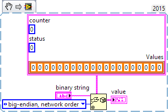

Unflatten from String should do what you want. You need a LabVIEW cluster that matches the struct. The array element of the struct should be a 20-element cluster in LabVIEW (create an empty array of the appropriate data type, wire it to "Array to Cluster," set cluster size to 20, create a control, put it into your overall cluster).
Use that new cluster as the type input to Unflatten from String. Wire the string from TCP Read into Unflatten from String. Set the endianness input, if necessary. In some cases you can use Type Cast instead of Unflatten from String, but then you don't get to pick endianness.

Or, much simpler, make the array into a cluster as I suggested:
Message 7 of 16
(6,120 Views)

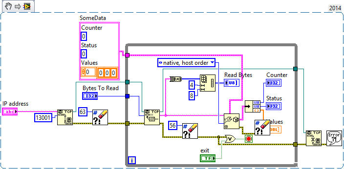

I have tried using Unflatten From String, but I constantly get error 116 (Unflatten or byte stream read operation failed due to corrupt, unexpected, or truncated data).  If I clear the errors after the Unflatten From String, then the counter and status come out correct, but values is empty.  The simple code I am using is the following. Note, I have modified my device and my code to have values of length 3, not 20, in order to make it simpler to see all the data.tcp_client_some_data.png
