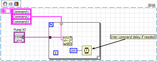

I usually do something like this.
=== Engineer Ambiguously ===
