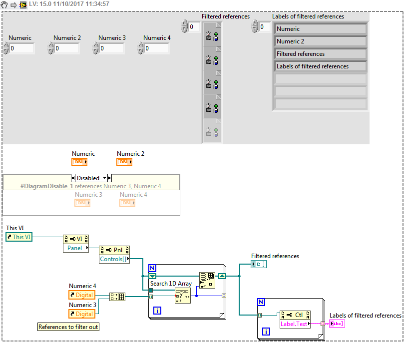

I guess to be semantically correct I'm talking about the terminals on the block diagram of which is the only thing you can place a disable diagram structure around.  The property I'm referring to is the Controls[] property from a Front Panel reference as shown in @Blokk's diagram above.

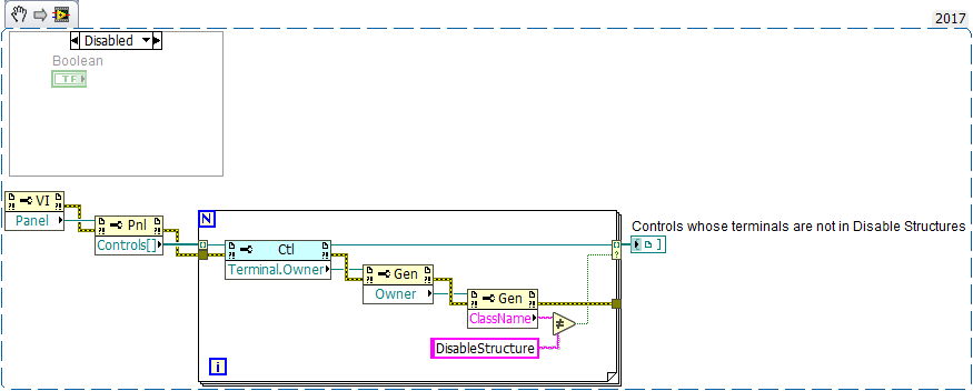

try looking at the owning object of each control...  If it's in a disabled structure, I imagine  that should show up as the owner.  Now you do run into problem if it is inside a case structure inside a disabled structure...
