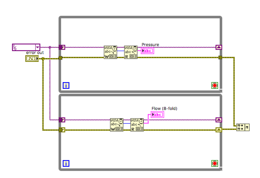

I am trying to create a measurement VI with a Queued message handler, with an addition of an acquisition loop  I have two simultanious measurements to conduct:
1. A pressure measurement (1 pressure meter, 1 control valve)
2. A flow measurement (8 pressure meters, 8 flow meters, 8 control valves).
These will all be connected to 1 bus system (RS-232).
So I want to have one  main vi in which I can start and stop both measurements separately. I was thinking about sharing the bus system VISA refnum between two parallel while loops, one while loop for the pressure measurement and one for the flow measurement.
Or should I try to put them both in one while loop and enable the measurements with a case structure around the VISA Read/write?
Any help will be greatly appreciated 🙂

Are you sure it's a RS-232 bus? RS-232 is point to point and cannot be used to talk to different instruments. May it be a RS-485 instead?
In any case, the serial bus is really serial: you cannot run communications in parallel this way. Do all queries in a single loop.
Second: you do not need the shift register, just wire the VISA resource constant to the VISA functions.
Your example code is very crude (you probably already know this): you don't write anything to the bus and probably you are not initializing shift registers properly (it seems that the resource constant is wired to a tunnel and not to the shift register).
Finally: you probably need to initialize the serial port and close it after the loop is stopped.

I agree, you should keep this in one loop.  You can run into weird conditions where the reply of one query could end up in the other's read.  There are other ways around this, but keeping it all in a single loop is a lot simpler.

Theoretically you could use this architecture safely, if you add VISA lock/unlock or semaphores around your write-read pairs so that they wouldn't collide with each other.

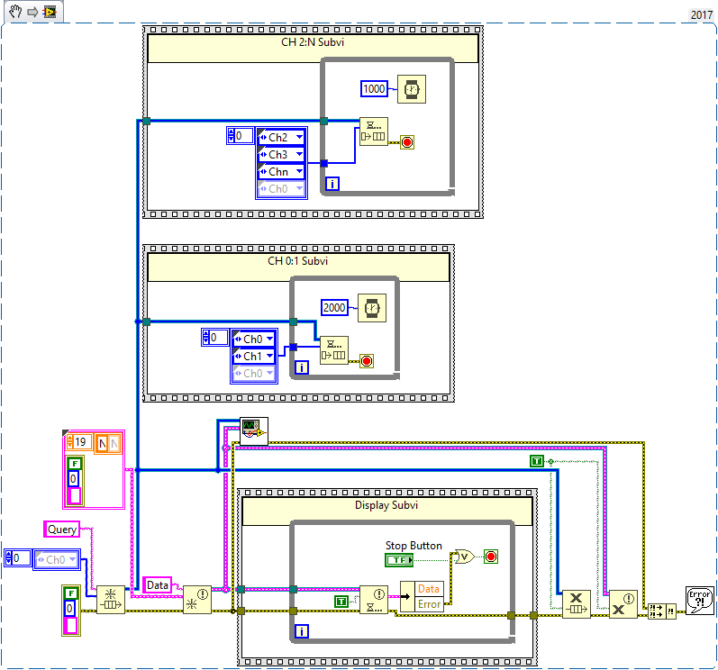

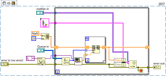

I would probably do something along these lines using a Queue and a Notifier
Not complete just the bones to start the scheme:
with Main
Calling a get

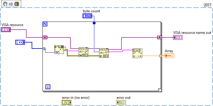

The Query is a simple W/R replae the to string and to data string functions with your device commands
