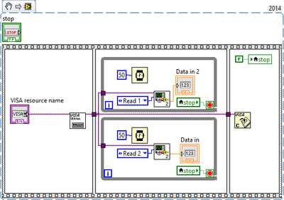

@Borjomy wrote:
that's even easierMain loopsMain loops
SubVISubVI
Hi Borjomy,
Have you seen my Nugget on Action Engines found here?
I ask because your suggestion is very close to the form of an Action Engine but requires the assistance of the seq frames to make it work right. Action Engines can offer a an approach that is just a little bit cleaner and easier to use.
Just trying to help,
Ben

Hi, Ben
Sequence is used here only to press the "Stop" button after stopping all cycles.

@Borjomy wrote:
Hi, Ben
...and ensure the session is not closed prematurely.
Ben

If the project is small, then it makes no sense to equip the library. This is an extra work. The main thing is that the exchange with devices connected to one VISA device should be done in one VI
All projects start small. What Jeff was suggesting is a Best Practice that I agree with strongly.
Thank you,
Ben
