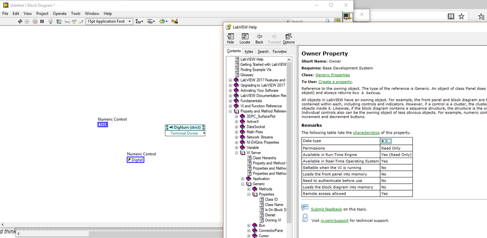

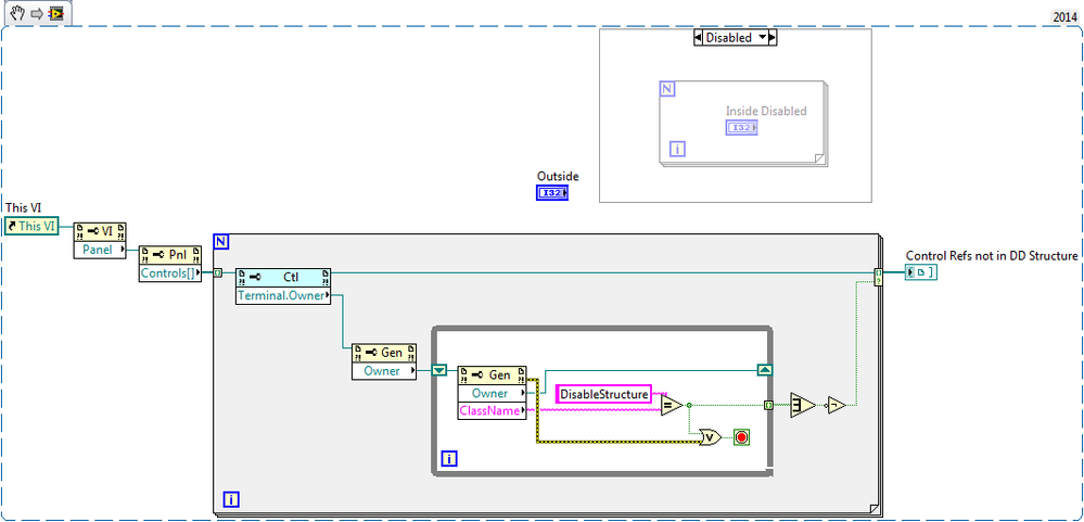

Accepted by topic author SeanDonner
You guys are awesome.  The Terminal.Owner property is exactly the key I was looking for.  Although as rightly pointed out that this would filter terminals inside the 'Enabled' state of a Disable Diagram Structure, I'll take it!  I took the provided example by paul_cardinale and extended it such that it still filters out terminals inside a Disable Diagram structure even if they are nested within other structures.
