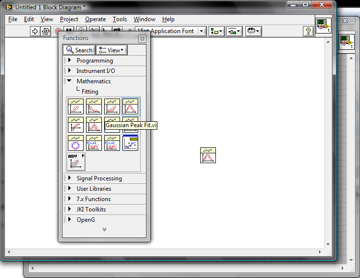

Have you tried the Gaussian Peak Fit.VI ?
The LabVIEW help extensively covers how to use this function. I think it is very good, you should give it a shot.

I think that must be a later version of Labview.  I have Labview 7.1 and that function is not available
