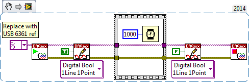

Here is some DAQmx code to start your 6361, set a Digital Output to True (TTL High), wait a second, then set it to False (TTL Low).  Have you tried plugging your device into your PC and firing up MAX?  It should "see" the device, and you can manipulate its ports to test it out.  Indeed, the name that MAX gives your device is what you'll put into that first I/O Constant on my example (if you click the drop-down symbol, you should see a list of the devices that MAX found).
Bob Schor

I didn't know that a digital line will create an ttl signal, I was thinking ttl signal as an analog output voltage

The "L" of TTL (Transitor-Transistor Logic) is "Logic", or Boolean, 0 or 1 (or Digital).
