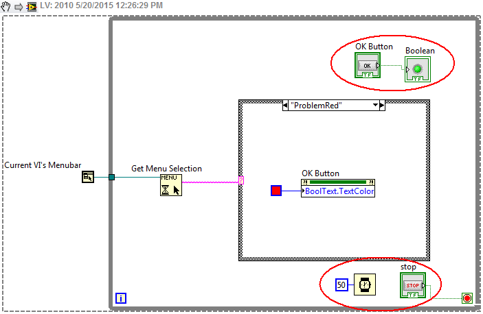

I'm trying to get a custom right-click menu to change the text color on a Boolean control without success. I've researched this online and in the Help files and my code seems correct, but no-go. I would greatly appreciate someone taking a look at the attached vi and tell me where I've gone wrong.

Although I had to create the menu myself, it worked for me.  Select a menu option then click stop and the button text changes color and the VI stops.  What do you expect to see?

Thanks for taking time to look over my code, sorry you had to build the menu, I thought it would go along with the vi.
I expected what you got, a color change on the Boolean text. It's good to know that at least the code works.
The fact that you had to create a menu may be a clue, I followed the Help file instructions and setup the menu first, before the case/while loop. Maybe that's wrong. I'll try it again.
But I do have another question. You mentioned that you selected the menu option and then hit STOP to get the color change. I was hoping that the color change would happen "on-the-fly" while the vi was still executing. But mine doesn't work either way. As you've probably already guessed this is part of a larger vi so I suppose I can always run this loop async and kill it off after the color change. Assuming I can ever get it to work.

Data flow!  Your large loop won't run until the small loop is stopped.  I moved that stuff into the larger loop and made Bob into my father's brother.

Have you tried the modifications I suggested?  What debugging steps have you tried?  I'd put a probe on the string feeding the selector terminal to see what you're getting from the Get Menu Selection.  Highlight Execution could also shed some light on where your data is going.
