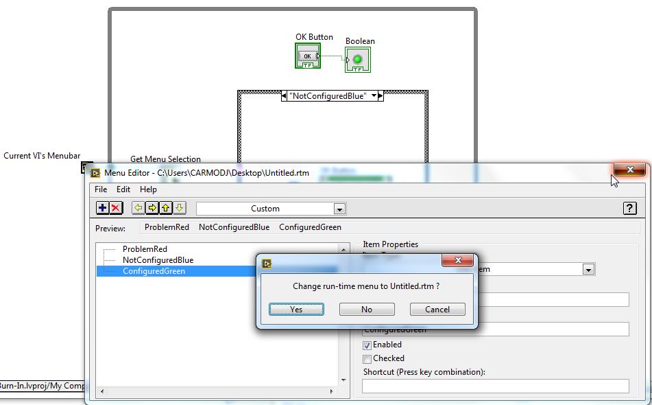

Thanks for hanging in with this, Jim.
I have made your changes, still doesn't work for me.
A probe placed on the selector line is always an empty string (not "Not Executed") indicating that the Get Menu Selection is probably not getting the menu data.
Highlight execution just shows the Read Menu constantly pinging the selector terminal through the GMS.
An interesting sidelight: I asked another fellow locally to see it he could run it like you did and it won't work for him either. He's running 2013 same as me except I've got SP1 installed and he doesn't. May I ask which version you're running?

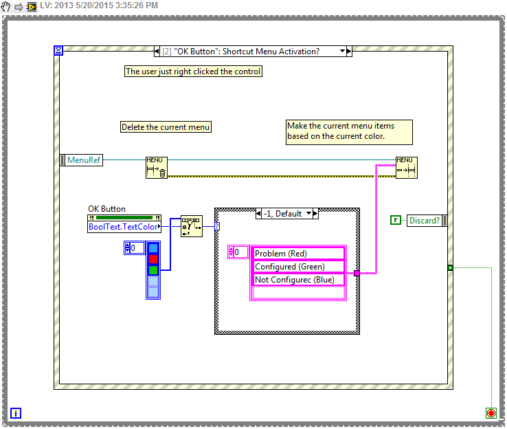

Attatched is a 2013 version which uses the event structure.  It also will recreate the menu as you click on it, based on the current color selection.  So if the color is Blue the item to change it to Blue isn't an option.
EDIT:  Here is a snippet
Message 15 of 22

Yes, I did complete the menu editor screen for all three "Tags".
When I first saved the new menu I chose the save it "with the control" option instead of creating a separate file. I have since saved it as a separate file and it is attached with a .txt extension, the forum choked on .rtm, so you'll need to change it back. Saving as a separate file didn't help, still won't change colors.
Took another shot at saving a 2010 version, and it is also attached.
Thanks.

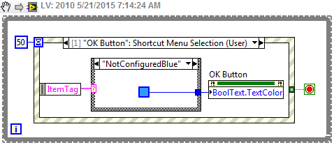

What we've had here was a failure to communicate.  You're setting the custom right-click menu of the control (I missed that) but reading the custom menu of the VI (Current VI's Menubar); your VI doesn't have a menubar.  It's no wonder it doesn't work.  Your control menu did come in your VI, though.
I don't believe you can get a reference to the control's menu but, as mentioned earlier, an Event structure is really the way to go.
Jim

That's really slick, Hooovahh, thanks for sharing. Best of all....it works!
