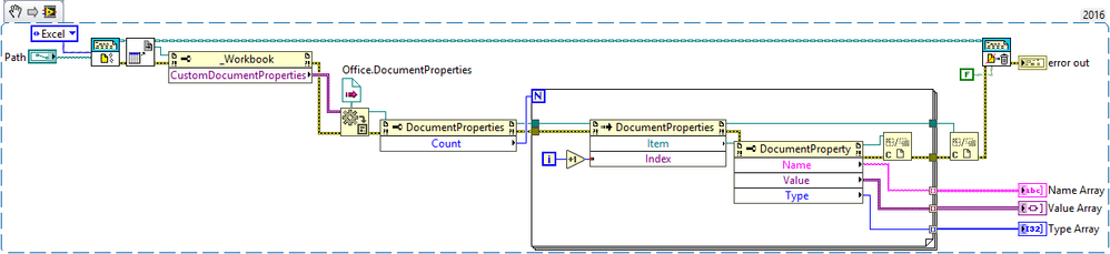

CustomDocumentProperties probably returns a variant because the custom properties can be of different type (text, number, date, yes or no). The following code should theoretically works. The type output can be use to convert the variant value to the proper datatype.
I specified theoretically because from the office pc the count property returns 0 Excel 2013) and from the home pc I get error 3008 (Excel 2010).
The Office.DocumentProperties class should be used, the Excel.CustomProperties class relates to worksheet object metadata.
Ben64

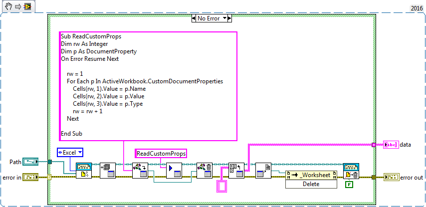

This doesn't work for me. As you said a Sub can't return value so instead I had it wrote the custom properties to a new worksheet, got the data using Excel Get Data.vi and then deleted the new worksheet. A bit ugly and twisted but it works well to get all the custom properties.
Ben64
