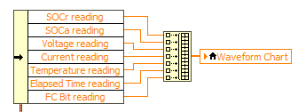

1. i am making some measurment program, and it works pretty well. I would like to get the data from every cycle into the waveform chart or in some kind of diagram so i can export it to Excel later.
I just dont understand how to connect the data to the plots? It would be great if someone could explain me (Release Data State in my program).
2. And i would also hear for someones idea or opinion how can i get the data into the diagram, for example, every 2 seconds or some normal periodical time.. i know that the way i did it  is not the best way to do it because the time axis wont be periodic.
Thanks in Advance!

As you can see in my program I dont know how to connect the terminals.. data to the plots ? I have tried a different solutions, but none worked.

Hi vlado,
as you have defined your chart to display an 1D array of data in the state "initialize graph" you need to provide the data in the very same format later on:
When you need/want to use a different data format (like a specific cluster as suggested in the help of the chart) you need to change this "init graph" state first!
Btw. it's irritating when your state is named "init graph" when you use a chart instead…

Well... it works but not the way i wanted. I would like to have 12 different plots (different color), and every plot should represent one "reading". On the x-Axis should be Elapsed Time reading... I have deleted the state "initialize graph"

Hi vlado,
Please read the context help for the chart - it will tell you which step you have to take to display "multiplot - 1 or more plots"!
(Hint: you need a different datatype than a 1D array then.)
Either change the formatting of the x axis to show time (together with setting a suitable x axis multiplier/offset) - or use waveforms with proper t0 timestamp…
All this is explained in the example VIs coming with LabVIEW. There are example VIs showing the usage of charts and graphs!
