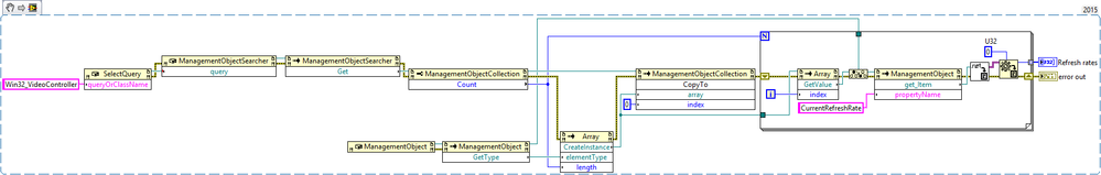

Here's a .NET API call version in 2015:
This is the following .NET code converted to LabVIEW:

Small note: I only have a 1-monitor system to test on, but in theory it should work for any amount.  It's not tested on more than one though.
