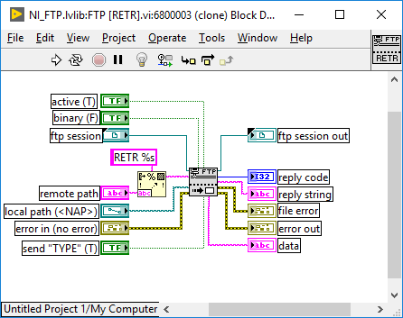

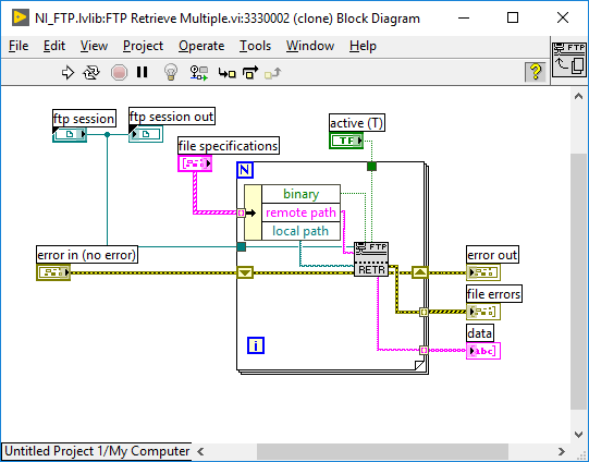

Just in case your question is more syntax-related: Did you know that you can look into most existing nodes?
Opening FTP Get Multiple Files.vi and consecutively sub-VIs used inside leads to:
Where FTP [RETR].vi is:
The next level of subVIs are very low-level FTP and have bigger block-diagrams, therefore I don't want to post them here.
