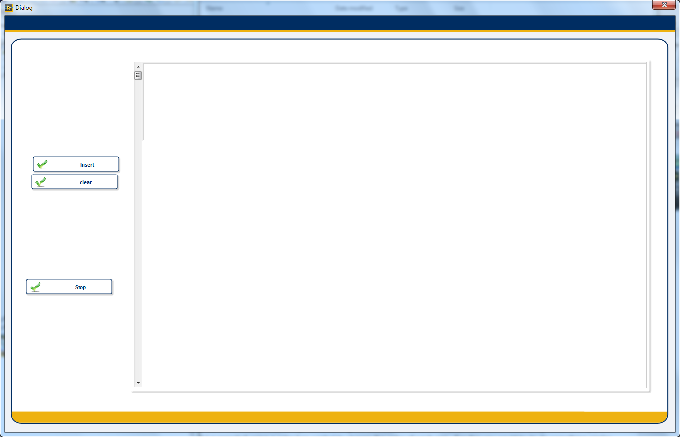

We can not put subpanels in an array but we can put them in a cluster and then make the cluster look like it is an array.
With no sub-panels inserted it can look like this.

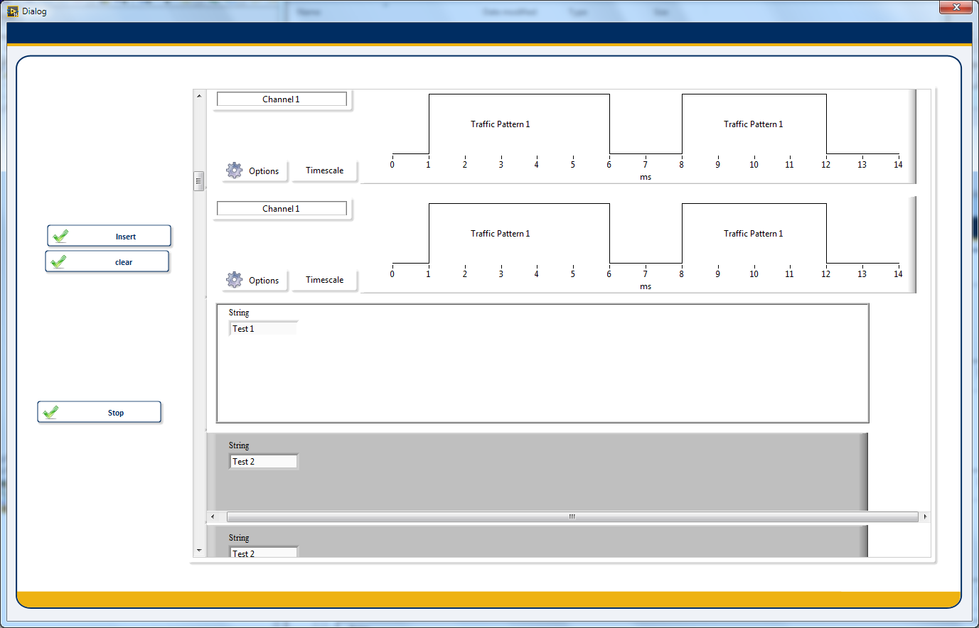

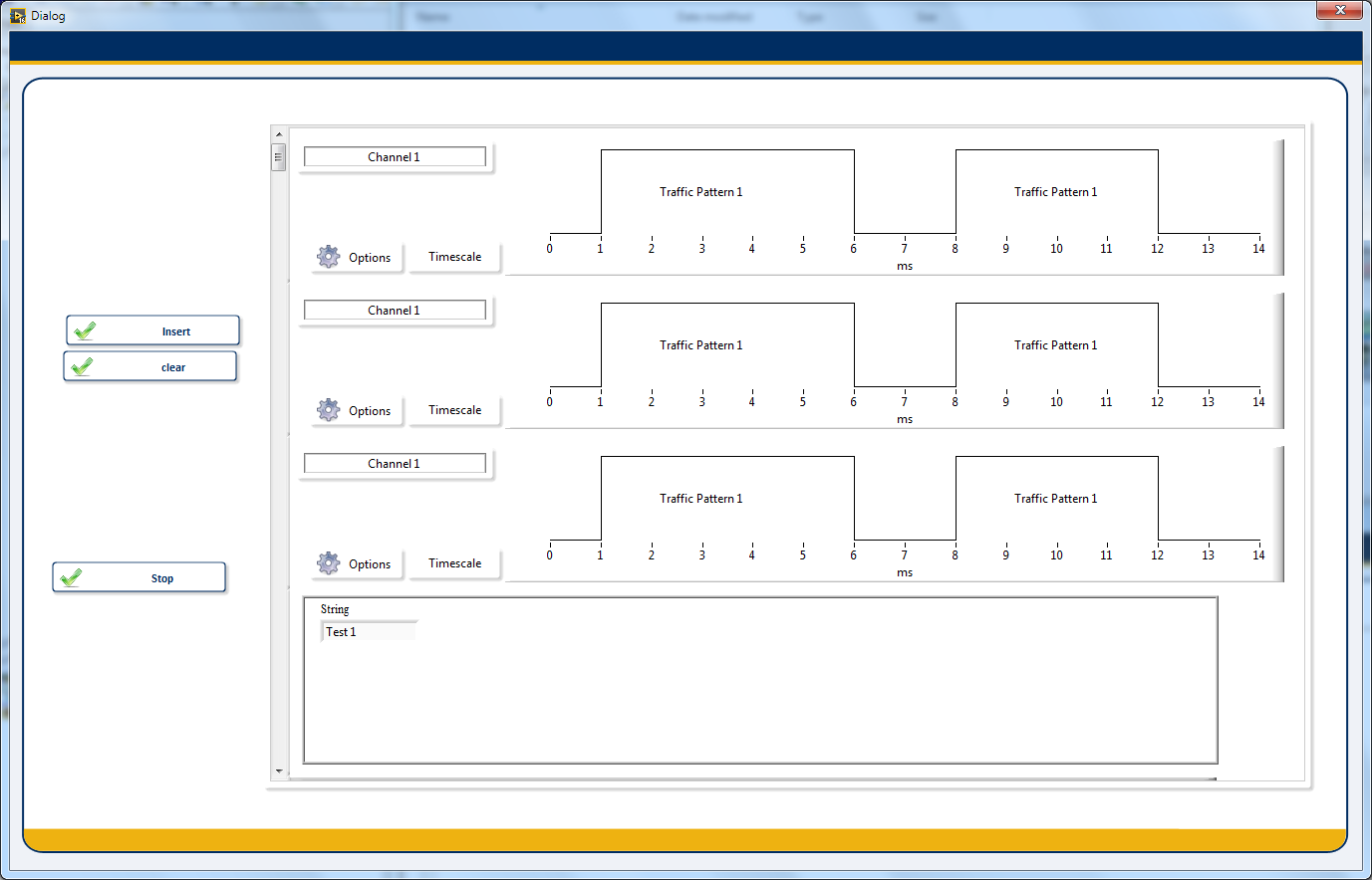

After inserting our selection of diverse sub-panels it looks like this.
Scrolling we can see what looks like dissimilar objects in an array.
