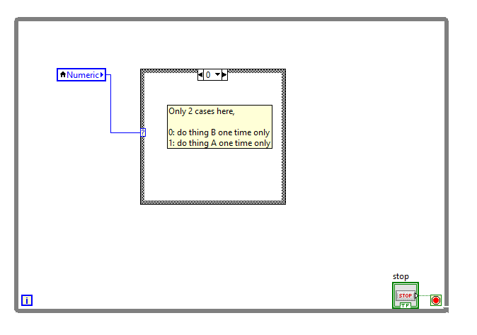

Dear friends,
I need some help, I wish to know how to implement this "simple" algorithm?

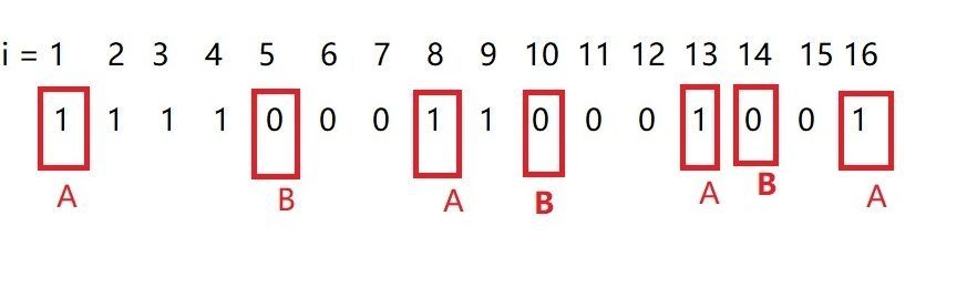

My goal, simply saying,  once meets 1 do thing A, meets 0 do thing B, but only do one time when meets bit changed.
In other words, I will do things (A or B) only I meet the first bit changed.
In other words again, in below pictures.
notes:  1. i is the the order of the whole loop.  2. the local variable, numeric, will give one number (0 or 1) for each iteration (just one number, not an array,e.g. in the top figure, i=1, got 1, i= 5, got 0... )
my goal, when meets the first bit changes, do things one time. That's why I put as in top picture, only in the red square, you do the thing one time (e.g. when i = 2,3,4, dont do anything. only do it one time, until meets the bit changes ).
May I ask give me some help about this. Could someone give me the vi,  it's not necessary to run, but please show me how to do this in this while loop?  Thank you in advance.

Right now, the problem is how to show this before and after value by using a feedback node or shift register......
The local variable is just a place giving the 1 or 0.

Actually, there is no code.....  I am doing a bigger project. I just abstract the question into this simple version. There are 2 state machines, one start machine will give the value to the local variable in 2nd state machines.
If you ask code, just the while loop, variable, and case structure. That's it.
