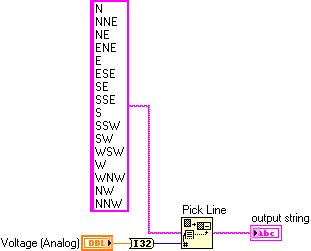

If you have them saved as an array or are taking them in real time, than these are two ways to give them names. One uses a Ring Indicator and other a String Indicator. Used the index array function for arbitary value selection(you can use a for loop for sequential extraction and cut off the index array function and the numeric control). The other one implements your thoughtout solution.

I assume your are talking about the cardinal direction.
The question I have is what is the relationship between the voltage and the direction.
What is the scaling of voltage to direction.
If it is a one to one then try this
Omar
(3,226 Views)

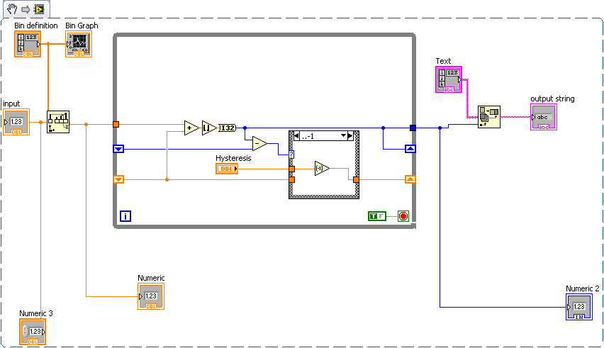

for real world signals with noise it might be wise to add a slight hysteresis to get a stable output near a boundary.
the attached program show one way to do it. By adding the hysteresis after the 1D threshold vi it is also 'scaled' to the range 🙂
