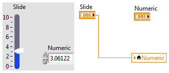

I'm trying to link two controls together, a slider and a numeric, so that if I change the value of one control, the other will also show the new value.

Right click on your slider.  In the menu go to Visibile Items->Digital Display.

rt click control,create local....connect other "control"

A slider and its digital display are two linked controls, exactly as requested. Tim's answer is correct and appropriate. No code needed. 🙂
You can "link" as many controls as you want this way, have a look at this old example with eight linked controls (and a single terminal!). (posted here)
