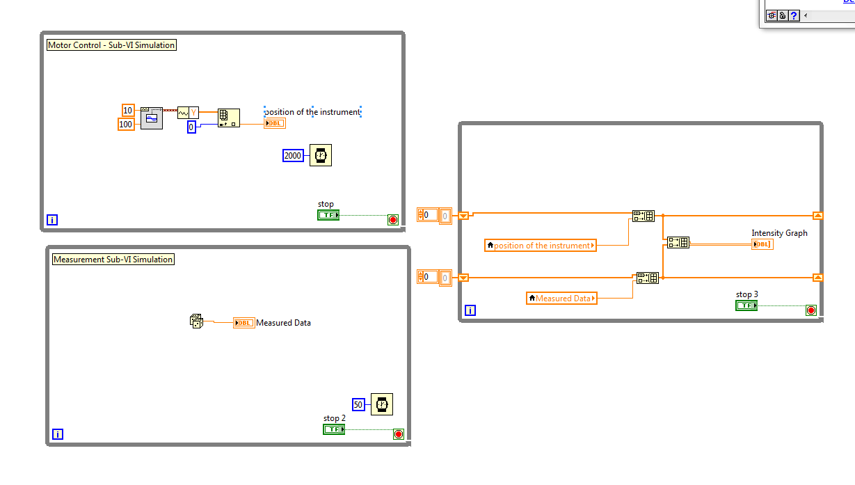

I made a small simulation Vi. But as I understood now, Labview can only scale the indices and not have a real matrix of data points with different distances.... So I need to have equal time distances and equal movements over the surface. I thought, I should track the actual position and give that arbitary parameters as an axis.simula.png

I think the example you sent is not reprensentative of what you are trying to do.  What do you mean exactly by a contour 3D plot? Here you only have two axes, position and measurement.

Yes, you are right, in my example the time is missing. (And the contour plot is called intensity graph in labview)...On the axes I want to have:
x: Time
y: Position of the instrument (Motor control is from Parker/Hannifin)
z: Measured Data (DAQ is 20MHz from adlink, model PCI-9812)
(3,543 Views)
"But as I understood now, Labview can only scale the indices and not have a real matrix of data points with different distances.... So I need to have equal time distances and equal movements over the surface."
This comment is applicable to "Intensity graph".  So you will need to duplicate the value of the sensor that has a lower sampling rate.
