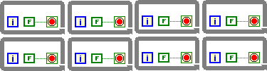

For example the following code (add more loops if you have even more cores!) can use all real CPUs, so you'll get near 100% on a regular CPU (and ~50% on a hyper-threaded CPU). What us the exact model of your processor?

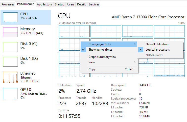

As a first step, the OP should set the "task manager...performance...CPU display" to "logical processors" instead of the default "overall utilization" (right-click on graph, see picture). This way we can easily tell of one CPU is pegged at 100%. Of course the OS will most likely shuffle the process around from core to core to even thermal load.

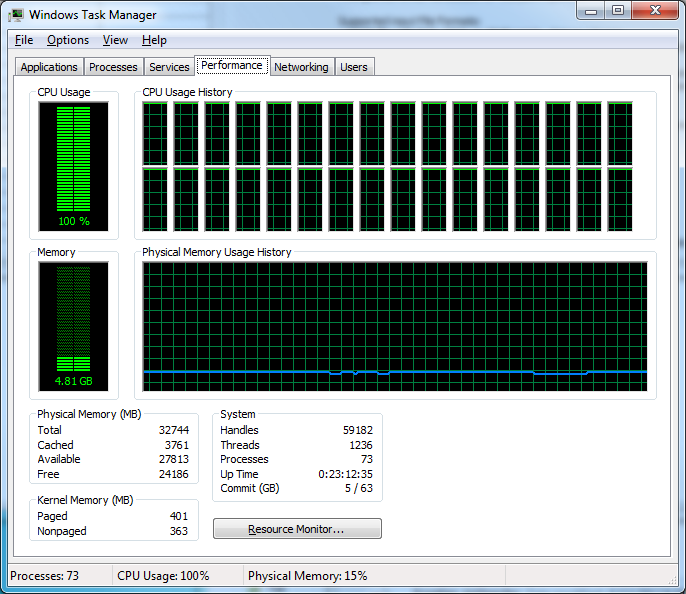

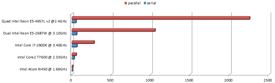

Yes, properly programmed, we can use 100% of all cores. Here's my 16 core (32 hyper-threaded cores) machine running one of my analysis programs 16+ times faster than on a single core (details).
