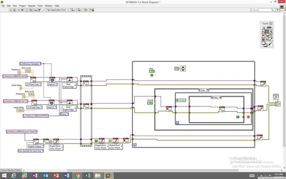

I have some issue.
I want to restart one counter output. When I turn on the pause switch, the one counter output pauses in the vi.
However, when I turn off the pause switch, the one counter dose not restart in the vi.
When I did not use trigger signal(start digital edge) in the vi, the one counter restarted. However, synchronization of the two output signal did not match. So, I needed trigger signal(start digital edge) in order to match synchronization.
How should I do to restart the counter output?
Here is my VI and the diagram
Thanks.

I'll walk through a literal description of your problem.  There are different ways to attempt to "solve" it, but I don't know what you really need to accomplish with this stop and restart.
1. You've configured 2 counter output tasks to be triggered off the same signal.  They have the same frequency but one has an initial delay.  Fine so far.
2. You also generate your own triggering signal and the task sequencing makes sure both counter output tasks are ready for it.  Thus, from one run to the next, you get precise relative timing of these two pulse trains.   Still fine.
3. You've then introduced a "pause" button that will be used to stop and re-start one of the pulse trains.  The nested case structure and polling loop isn't a particularly advisable approach, but the literal problem is that the restarted task is again waiting for a triggering edge on PFI0.  Since you don't generate another one, the pulse train never restarts.  This is core of the problem.
4. Even if you *did* generate another triggering pulse, you wouldn't re-establish the original timing relationship between the pulse trains because the other counter just keeps running continuously and won't react to further trigger edges.
5. To reestablish the original timing relationship, you'd need to stop and restart both counter tasks, then generate a new triggering pulse to sync them.
-Kevin P

I also worried that the I would not be able to re-establish the original time interval relationship between two counter outputs.
I will re-generate the both outputs or will find other ways to sync the signals.
I really appreciate your help.
Thank you.

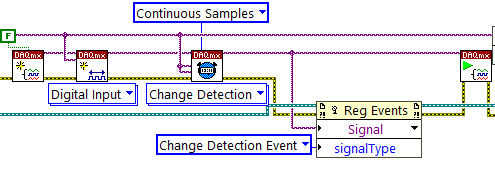

@Kevin_Price wrote:
2. Thus, you should probably *also* poll the limit switch states with a DI task.  When you detect that one of them has tripped, you know it's appropriate to stop the pulse train task that moved the motor into that limit switch.  And once you do stop it, you further know that you're now free to start the other one.
Not sure if this is relevant, but rather than polling the DI task, you can set up a Change Detection Event, a read it when it triggers the Event Structure, see below.
mcduff

I agree that the "change detection" approach is better than polling if the DAQ device supports it.  It didn't occur to me at first because I earned my DAQ stripes back when change detection was a fairly rare and exotic feature.  These days, it's pretty likely that a board with 2 counters will also support change detection for DI.   Thanks for the reminder!
-Kevin P
