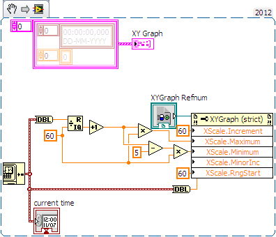

I have an XY graph, where I plot values against time.
To de-clutter the X-scale, I have chosen to hide the seconds (only hours and minutes are shown).
Now it looks like there are duplicate numbers on the X-scale (marked in red).
I've tried adjusting some XScale properties such as 'minor increment' to 60, as I thought this would limit the numbers to 1 for every minute.
How can I prevent this behaviour?

The problem may be that you are overwriting your reference, and so you changing the increment is not having any effect. Instead of wiring your array seperately to the graph, try putting a 'Value' property in your refence and wire your data up there, to prevent it getting written over.
I have had this problem before and this was what the problem was.

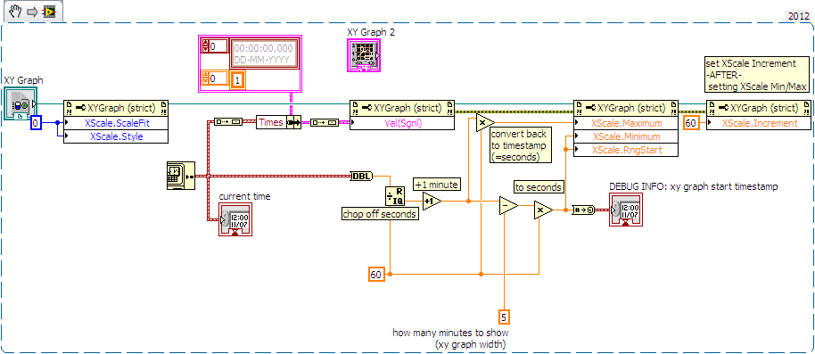

This seems to work. Note the setting of XScale.Increment AFTER setting XScale Min/Max.
If you don't, the scale is messed up once every full minute (when seconds are 0)
PS: to make this example work, delete the 'XY graph reference', and replace it with a new one you make from 'XY Graph 2'. Common vi-snippet problem I've learned.

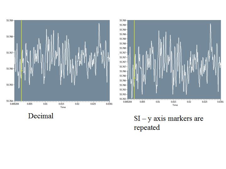

I found that y axis scale markers can be repeated if the format is 'SI' - marker spacing is less than the increment. Switching to 'decimal' results in markers with unique markers.
