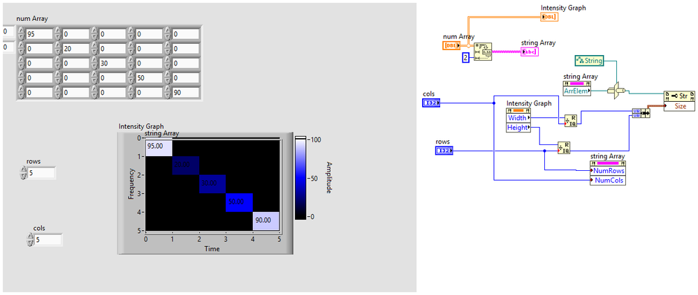

I don't know of a property that will allow you to show the numbers within the graph.  One option would be to display an array of the same physical dimensions as the plot area (with a transparent background) and overlay it on top of the graph.

You can't resize numeric array elements, but you can resize string elements, so I would just convert to string and do something like this, with some cleanup, of course.
This is very rudimentary, but should work
EDIT: the height and width for the intensity graph are for the plot area size, not the entire graph

Nirut, see the edited post.   It's there
