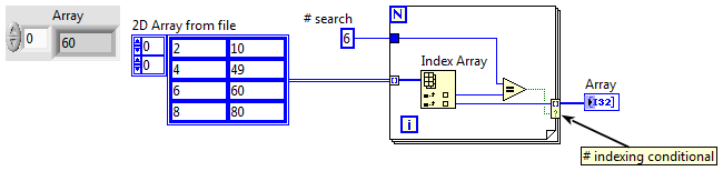

@apok wrote:
Why autoindex the output?  You should only have 1 output.  Besides, the Search 1D Array is simpler (no loop needed).
Message 4 of 18
(4,371 Views)
@crossrulz wrote:
might be 2 cases associated with that # and how does using a for loop make it any less simpler? is this a matter of opinion....wonder what the bench marks are?

apok wrote: might be 2 cases associated with that # and how does using a for loop make it any less simpler?
Both methods are flawed. Tim's solution will not correctly work if no match is found.
The FOR loop version will return an array (possibly empty). Since the requred output is a scalar, it also does not solve the problem.
