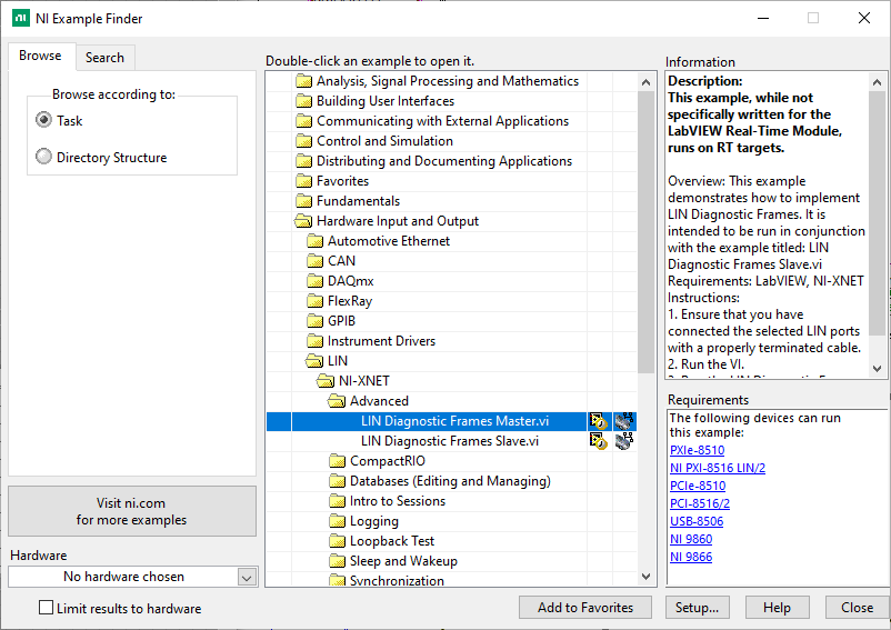

ID 0x3C and 0x3D are reserved for diagnostic. You must use the diagnostic examples shared by JB, as it contains the crucial LIN Diagnotic Schedule Change VI.

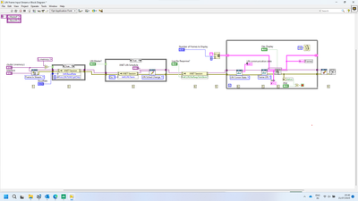

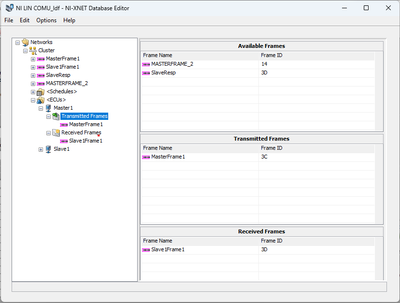

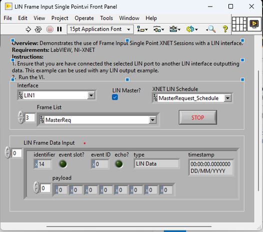

I will using this code sir
Screenshot 2023-07-21 092847.pngScreenshot 2023-07-21 092847.pngScreenshot 2023-07-21 234057.pngScreenshot 2023-07-21 234057.pngScreenshot 2023-07-21 234241.pngScreenshot 2023-07-21 234241.png
I have mentioned that in my previous post. You must use LIN Diagnostic Schedule Change VI to change to Master Request and Slave Response mode
https://tmesystems.net/

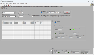

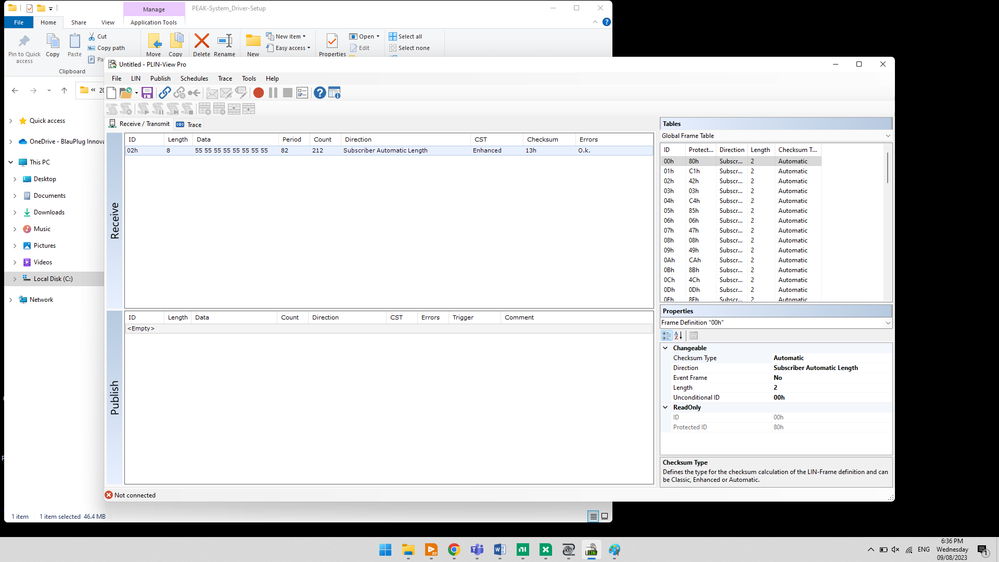

Sir i have read the subscriber data without transmitting any master commands.Is it possible to read the data.In PLIN View Pro without transmitting any master frames i am getting data. In labview also it is possible to read the data using LIN usb 8506 module without transmitting any master commands.lin2.pnglin2.pnglin1.pnglin1.png

What you are trying to do is to simulate a slave node using a USB-8506 and receive the frames sent by a master node as a subscriber. A subscriber subscribes to data sent from master nodes and reacts to it.
You can use any examples with input sessions. See Help >> Find Examples... >> Hardware Input and Output >> LIN >> NI-XNET >> Intro to Sessions
Select the frame or signal that you would like to receive or subscribe to, and leave LIN Master? option unchecked. You don't have to modify the XNET LIN Schedule as a slave node. Then you are good to run the VI.
