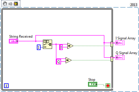

How to separate and group string?
I'm working on a radar project, and propose to receive two types of signal in labview through serial port.
The receiving signal is like:
I350
Q350
I250
Q150
IXXX
QXXX
one signal with header I, the other one with header Q, my question is how can I group string with header I together in one array, and group string with header Q in another array?
Message 1 of 21
(4,463 Views)
Hi yatang,
Are you using LabVIEW 2012 or later? If so, I believe this code should work for you.
Just use String Subset to extract the first letter, then compare it with I and Q, and finally, use the auto-indexing with conditional tunnel to separate out signals that starts with I and starts with Q.
Link about auto-indexing with conditional tunnel: https://www.ni.com/docs/en-US/bundle/labview/page/conditionally-writing-values-to-loop-output-tunnel...
Hope this will be helpful.

Fantastic!! Thank you very much!! I'll try this method!!

Thank you! And  I have another question, please have a look on this code, I tried two ways to display the graph after FFT, but there's no graph displayed T_T
Message 7 of 21
(4,346 Views)
That would be becaues you a feeding an array of size 1 into the FFT
(Get rid of those DDTs- they are only letting you mis-wire your data.
Message 8 of 21
(4,338 Views)
OK, so I should build a array, thank you!
Message 9 of 21
(4,325 Views)
