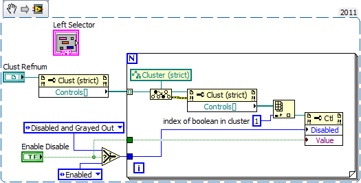

Restructure your data.  Make a cluster containing the Tube ring (which, as I mentioned in a previous reply, should be an enum), the Prog boolean, and the Order numeric.  Then put several of those into the Selector cluster.  That will make it much easier to iterate through the cluster, enabling or disabling only the Prog boolean.
See image below (Clust Refnum and the property node to which it is attached should be replaced with an implicit property node referring to Left Selector) and attached VI:

By the way, are you sure that you chose the right boolean action for the Enable Disable button?

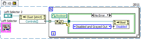

You can use VI Scripting to do it. Traverse For GObjects to be more specific:
If you are not familiar with scripting - google it 😉
Message 4 of 11
(4,318 Views)

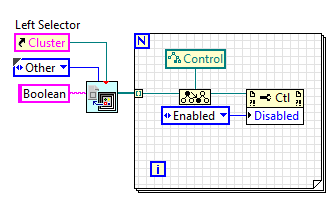

There's no scripting there, just standard VI properties.  It could equivalently be done like this:

Yes, that's probably causing the error.  I used a couple of tricks in putting that VI together.  One of them is that I dropped the inner cluster on the front panel, created a reference to it, created a constant from the reference, then deleted the front panel object.  What's left is a constant reference to a cluster type that is "strict" because it refers to a cluster with that specific set of elements.
Another trick is that the inner cluster is a "classic" cluster (instead of a "modern" one).  The classic cluster can be made fully transparent with the painting tool, so that it does not appear as a separate cluster on the front panel.  That inner cluster really should be a type definition - probably a strict type definition, although in that case you need to rework the so the "Tube" numbers line up the way you'd like - but I figured I was putting this together quickly and didn't bother with the typedef.
