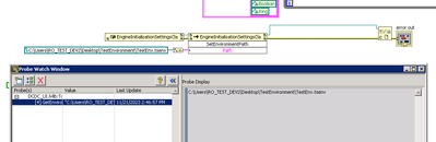

Hello, I am trying to set a Testsand environment file from labview but it doesnt work, or maybe how can I see that?
I used this link( How to Set TestStand Environment in LabVIEW Custom UI - NI ), everything ok so far,  and when I check the path, its ok, but after I open a Test Stand File, its the old environment.
Maybe I did something wrong, or I dont know how to check it, something is missing for me too.
Can you please help me?

From the link you provide, step 4. "Note that this needs to be done before the TestStand Engine is initialized and hence needs to be the first piece of code that gets executed when launching the custom UI."
You put the code left to the loop that doesn't mean it will be executed before the loop.
Have you tried to enforce the data flow?
