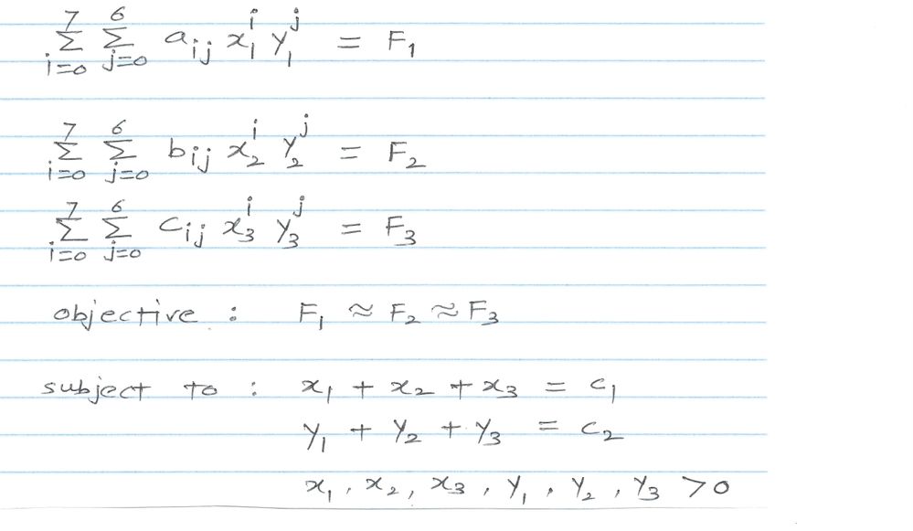

I am trying to solve a constrained nonlinear optimization problem, which involves 6 variables (and possibly more). Attached is the problem formulation. I started writing a program using the example VI "Find Global Min on Surface.vi". I assumed that though this VI is written for 2 variables, it will also work for larger number of variables. The sub VI "Find Global Min On Surface_Func.vi" shows a template of how to define the objective function and equality/inequality constraints. However, it does not really provide much documentation on how to specify those constraints.

Hi Bob,
Thank you so much for the response! Yes, the constraint is on the Xs and Ys to be in the positive octant, so we need to actually vary the values of x and y, so that the functions F will result in approximately equal values. The aij, bij and cij are constants, where i=0 to 7 and j=0 to 6. You guidance is very much needed.

The Find Global Min on Surface.vi example uses Global Optimization.vi
When creating your objective function, keep in mind:
1. The equality constraints are specified to have a value of 0.  So you should express the constraint as x1+x2+x3-c1=0
2. The inequality constraints are specified to be less than 0. In your example, you should express this as -x1<0, -x2<0, etc.
3. You will need to define a more proper objective function. If you want F1=F2=F3, then consider the pairwise distances.
For example, F_obj=(F1-F2)^2 + (F1-F3)^2 + (F2-F3)^2
I have attached a quick implementation of your equations as a global optimization objective function. Not optimal, but I think it is close to what you are looking for. Please notice the passing of the constants using the 'data' control.
