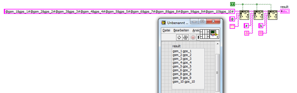

Hi l12,
split the string at those #@ chars...
(Replace #@ by a LF and the & by a tab char.)

An image to my suggestion:
The missing formatting stuff is up to you…
