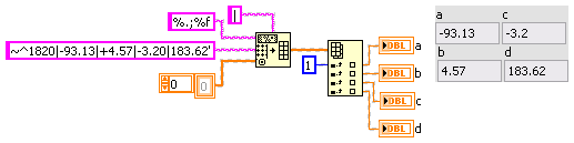

Hi
Try using "Spreadsheet String To Array"  as mentioned in below image

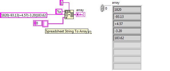

Hi Ankit,
use SpreadsheetStringToArray:

Hi Ankit,
my example shows the single elements of the array! What else do you need?

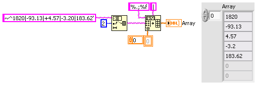

It's less scalable (so I don't exactly recommend this), but you could also use Scan  From String.
Again, I recommend Gerd's solution of using the Spreadsheet String To Array after using the Substring to remove the first two characters.
