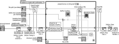

So would it be something like this ? It is not quite an array in this case however there is the use of shift registers. I have question marks regarding setting the buffer size, should I initialise an array outside the loop, are there issues with cases where data is missed, (or can it happen that a tiny number of data is inserted in excess to the sample number per loop?), will it be a ring buffer-> if yes, how to make sure that the graph is represented correctly when plotted-> this means the end part does not end up to the front? how to deal with timestamps if we are using a ring buffer-> If there is an example I could find where this was done using an array this would be great.
source: https://flylib.com/books/en/3.352.1.146/1/

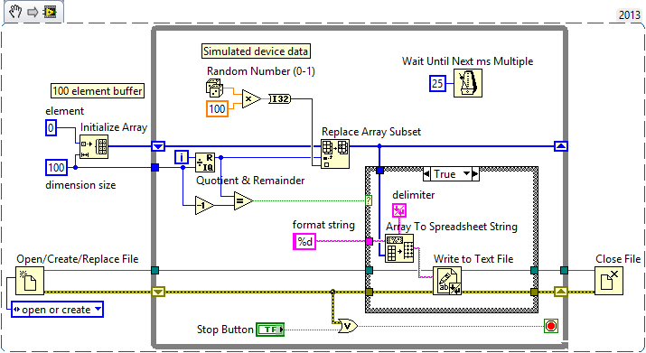

I saw this example, on stack overflow, I think I could use something like this: (however the idea of circular buffer in relation to plotting the graph and not having the end part appearing in front is still unclear to me.. I would have probably cleared the buffer after each measurement and not use a circular buffer..)
enter image description here
Edit2, missing source: https://stackoverflow.com/questions/34791801/labview-buffer-data-then-save-to-excel-file
