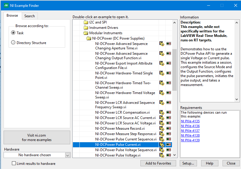

Could you please share a signal diagram depicting the relationship between signals and timing?
I am trying to see if you need a reasonable or tight synchronization.
In the meantime, please do check out the Pulse Current example,
