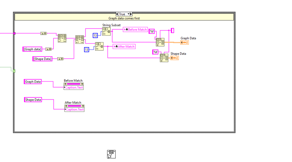

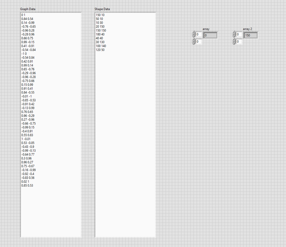

My apologies. Here are photos of my front panel and block diagram.

Make sure you're expanding the array indicator both vertically AND horizontally.
And post your code, not just pictures (Select All, Edit: Create Snipped from Selection).
