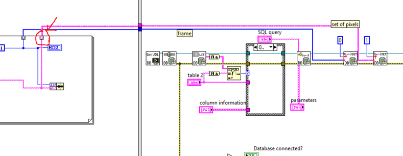

I created a table with the 2 columns, but with error and blank values in column1. Since, MS Access doesn't allow string lengths  greater than 255 characters, so I have changed to Memo datytape for Column1 in the Design View of the Navigation Pane in MS Access. I am not sure how to insert the pixels coordinates  now in the table(which was already created)without any error. Instead of using DB Tools Insert Data.VI, I have tried using parametrized query. But , it throws me an error (in the attached image).
Can someone help me how to insert values in a Memo field or any relevant information?

You aren't inserting a string.  You are inserting an array.

Yes correct. I corrected it and it works fine now. Thank you so much Aputman.
