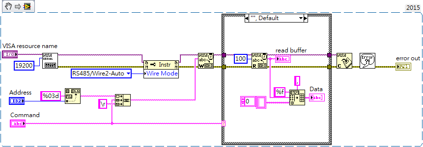

I connect it with the serial port(through a RS232 to RS485 converter) on the NI cRIO 9024, and use the following code to get the data.
Since I have a module of NI 9871, I'd like to move the cable to that module.
I dragged the VI to the target and selected the VISA resource name to ASRL2::INSTR.
I reconnected the cable to the device.
After running the program, it failed with a timeout error.

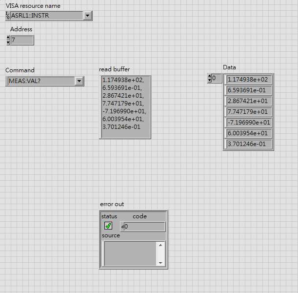

From the screenshot you posted with the device connected to the cRIO, it looks like you are sending/receiving data from the device - but the data itself looks different. It looks like you're receiving the same data that you transmitted - are you sure you don't have your RX/TX wires crossed? Is there some kind of loopback happening? I guess the 232-485 converter expects the %03d to forward to the correct 485 address?

In fact, the communication between the COM port of the NI 9024 and the device through RS232/485 converteris okay.
You can see I can get the data from the screenshot.

Is your second screenshot where you get the timeout error from the 9871? It shows you are reading some data (but it is reading the data you are transmitting).
The timeout error will be because you are not reading the correct data. It reads the "007MEAS:VAL\n" and then stops because no more data is received. Do you have the cabling wired up as per the datasheet for the module, including the external power supply? http://www.ni.com/pdf/manuals/372277e.pdf

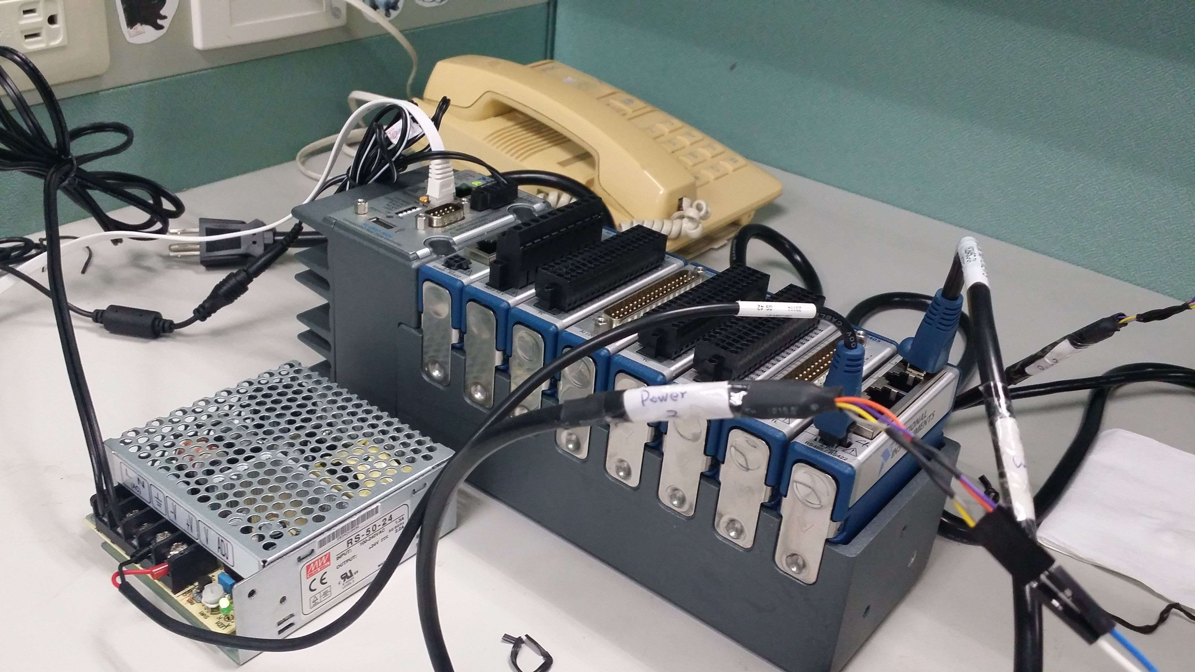

I connected an external power supply (24V) to the module, and separated the cable into two parts(purple & orange : +; gray & yellow : -) and connected them with the device terminals.
Is it possible there is something wrong with my code? But even the NI-MAX failed to communicate with the device...

Are you using a 2-wire connection or a 4-wire (full duplex) RS485 connection? I think there is a property node you can set you can set on the VISA resource to select this (and actually...now that I think about it - that might be the problem here):

You are awesome!!! It works when I added the property node of Wire Mode!
