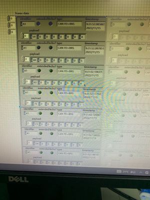

_0-1672105499939.jpeglike this rollingcounter  frame.

thanks very much,if I have many different ID frame data (it is rolling frame data),like picture (it is a arrary).i must  a frame execute a whileloop?  do you have some ideas or experience about this.  i have do this classify ,10ms 20ms ,50ms,100ms,500ms.but sometimes it still have DTC. the writeFrame API can allow write in the different whileloop in the time.

You can run multiple sessions for a single interface. However, you will need multiple parallel sessions and while loops for different frame IDs of different transmit time.
An easy configuration-based solution would be using the Vehicle Communication Toolkit. You can configure the signals to be a rolling counter or checksum and the toolkit will handle the underlying payload modification for you. However, this toolkit is not free.
