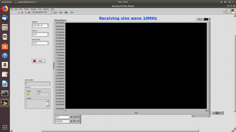

This is the sample program, which i want to run on ARM processor (Zedboard Zynq 7z020clg484). Data received through ethernet is displayed on this GUI.
This is working fine on ubuntu 18 on laptop and also on Windows.
