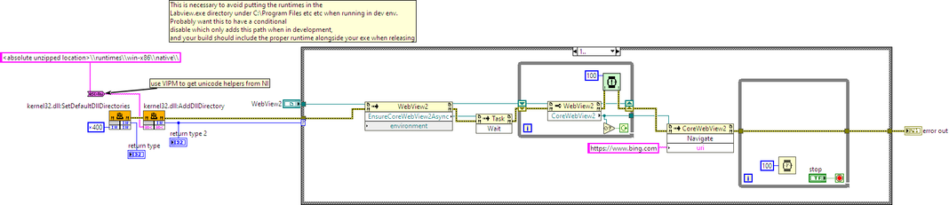

I just got this working. I followed what Microsoft says here and installed the runtime. I then downloaded the webview2 package from the nuget repository. Once that was done i change the nupkg extension to .zip and then unzipped it. I then added a .net control on the LV front panel. I linked it to the webview2 control, and shown below is the block diagram with some comments.
edit: you can probably remove the while loop around the CoreWebView reference. That was added before I got the wait on the async call to work correctly and I didn't remove it.
Hope this helps:

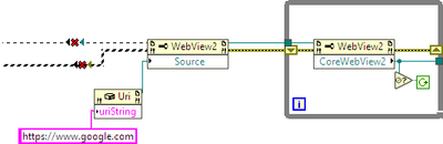

As an update, i'm finding the method used in my previous post sometimes hangs up. I'm guessing it has to do with the synchronization context of the Wait() method but I can't be sure.
Either way, using the source property to initialize the browser and then polling for a valid reference seems to work more consistently:
Message 7 of 32

Please see me latest reply, not the one you marked as an answer. Does that freeze up as well? I had better results with that.
Very interesting about the open file dialog...Not sure what's going on there.
Edit: I removed the CLFN calls which are being used to set the DLL paths. I then copied the WebView2 DLLs and the Releases directory into C:\Program Files (x86)\National Instruments\LabVIEW 2019. This works. That means the problem is being caused by the calls that are adding paths to the DLL search path.
So you can either troubleshoot that, or just copy the DLLs into the LabVIEW directory to make it work in the development environment, then remove the CLFNs. This is a bit ugly having to copy into C:\Program Files but it's what we're stuck with unless the WebView2 project owners allow the path to be set programmatically.
