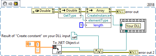

You could try one or both of these options:
The "Double" and "Array" types are in the "mscorlib" assembly.  "To .NET object.vi" is in the ".NET" palette.

Kyle,
I tried your second suggested method, but get an error message. Any further suggestion? Meanwhile I'll try your first method. I appreciate your help.

Kyle,
Meanwhile which "object" in the mscorelib contains the "double" and "array" constructors that you used in your first example? There is a lot in that library. Thanks.
Message 5 of 21
(5,907 Views)
Look under "System" and you will find those classes.

Tyk007,
I found "double in "system", however "array" is problematic.
Message 8 of 21
(5,903 Views)
If you re-check Kyle97330's post the Array is created using a static method on Array. Check that you aren't trying to find a constructor and a browsing for an Invoke node.
