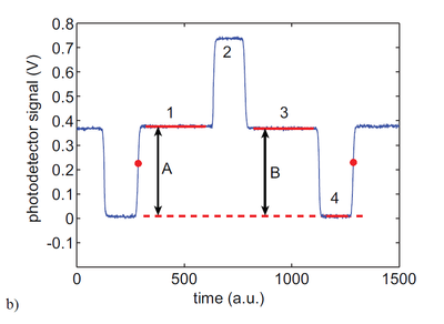

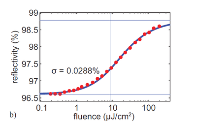

I’d like to ask a question regarding graph transformations.
I would like to transform the left graph into the right one.
For the x-axis, I used a calculated value. For example,
3 W80 MHz=37.5 nJ\frac{3\,\text{W}}{80\,\text{MHz}} = 37.5\,\text{nJ}.
Given that A=0.00785 cm2A = 0.00785\,\text{cm}^2, I calculated
f=37.5 nJAf = \frac{37.5\,\text{nJ}}{A}, which results in 4.78 μJ/cm24.78\,\mu\text{J/cm}^2.
This value was used for the x-axis using a division operation.
The problem lies with the y-axis.
Originally, I calculated reflectivity as BA\frac{B}{A} using data from the left graph.
However, to correct for the background signal, I need to apply the following expression:
What is the best way to use arrays to implement this calculation?

sorry, I'm not sure I've caught your question correctly. Do you want to figure out a way to extract A, B, 1, 2 ,3 and 4?

Your description is very hard to understand. The forum editor does not render your formulas, thus you should try to just insert pictures of the formulas  instead.
I don't understand how you can get a smooth curve covering more that four orders of magnitude in X from just four readings.
Can you attach a VI with typical data?
