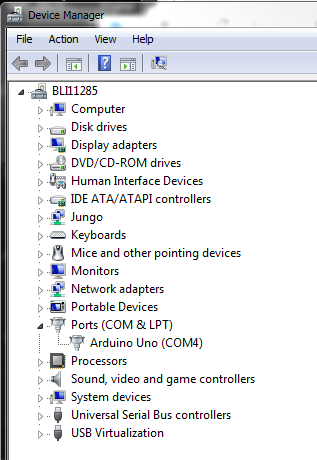

Does the Arduino's virtual com port show up in Windows Device Manager when the Arduino is plugged in?
In Windows 7 it looks like this:

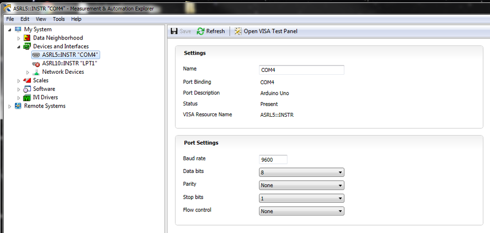

Then in NI-MAX it should look like this:
If all that is working correctly then the com port should show up in the VISA resource selection in LabVIEW.

I try to communicate LabView with my Arduino. In labView I can do VI's and all the functions but if I try to communicate it through “VISA Serial Port Configuration" in labview does not appear the ports COM when I want to choose the port where I have connected the arduino. So I go to the Arduino IDE and it detected, I can write on it through IDE also I check in the device manager and my computer does recognize that my arduino is connected, I don't know what more can I do

yes in the device manager it appear but in labview when I try to communicate through the “VISA Serial Port Configuration" when I try to choose de COM port, it does not appear.

Hi Ozvaldo5,
A good place to start looking is probably at this forum post where another customer accomplished a similar task:
How to read Serial Data from Arduino using labview VISA?
https://forums.ni.com/t5/LabVIEW/How-to-read-Serial-Data-from-Arduino-using-labview-VISA/td-p/149786...
As far as selecting the COM port as a VISA resource it looks like the VISA resource name for this COM port is ASRL5::INSTR. Can you select that as the VISA resource?
