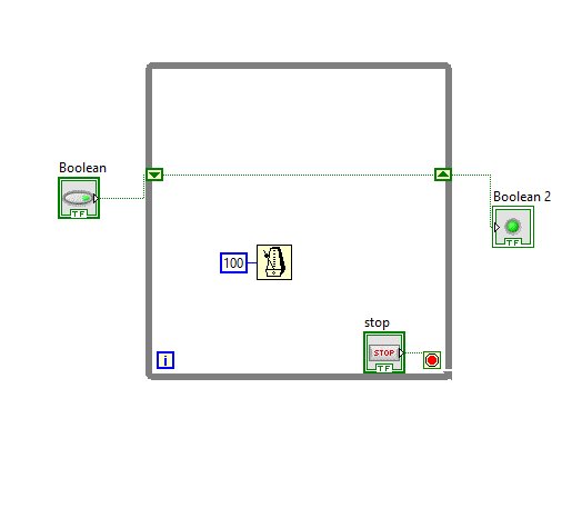

Do you mean this, or is there any corrections, its not working
Capture
This will not work, because the controls is read only once before the loop starts and the indicator is only updated once the loop has finished. It is called "dataflow".

OK, I was looking at your first code and it is apparent that you think that LabVIEW is a circuit simulator (!).
This is wrong! LabVIEW is a full featured programming language that uses graphical code to represent computer instructions and uses the principles of dataflow to determine execution order. Graphical code has many advantages, for example you can program several independent parallel processes on the same diagram if needed.
A simpler problem would be to change the switch to latch action (it will be true until the code reads the new state and then switches back to false automatically). Would that be sufficient? If you want a switch action boolean (as you currently have), you simply need to toggle the output whenever the switch goes from FALSE>TRUE. All you need for that is code the size of a postage stamp and it probably has been posted before here (I have an image in my image library, but I don't know where it has been posted before* ;))
