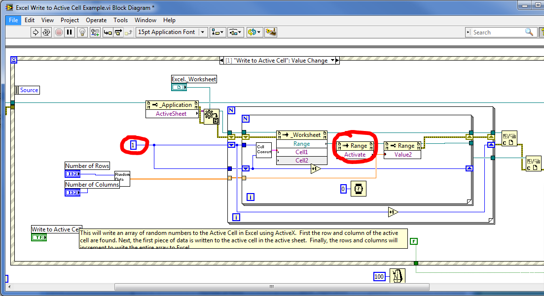

Rather than "get" the active cell, you will need to "set" the active cell.  In the example below, I am activating cell 1,1 which is converted to A1.

that looks easy enough, thanks

You retrieved the sheet specified but did not select it (or do anything with it). Your code attempted to continue on the worksheet that was selected by default. Additionally, the code you were given is EXTREMELY slow for writing an array to a range. Use both the Cell1 and Cell2 properties to get a reference to the entire range then set the value, once. The attached VI should work and be considerably faster.

Don't use 0,0.  The cells start at 1,1.
Good point, I presumed that either test stand was wiring in a non-zero value or the Convert Cell (that was not included) was handling that case. I also missed adding the array size to the start cell. See attached...
